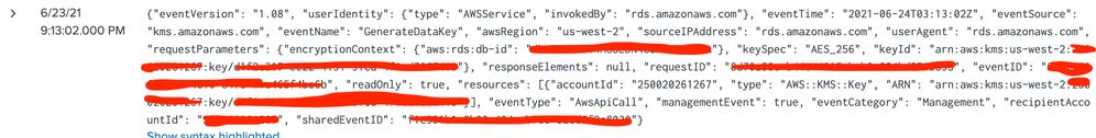

Hi @ColinJacksonPS
Can you share sample event how it looks like covering Get*, List*, LookupEvents etc.. I am sure they don not start at very beginning of event since you mentioned ^ in regex which indicates very beginning of event.  REGEX shall be changed to match with event.

Here's what I can share. If this is working, readOnly=true should return no results, or at least those listed.  Raw, JSON formatted, and simple stats output.
Screen Shot 2021-06-23 at 9.27.21 PM.pngScreen Shot 2021-06-23 at 9.27.21 PM.pngScreen Shot 2021-06-23 at 9.26.57 PM.pngScreen Shot 2021-06-23 at 9.26.57 PM.pngScreen Shot 2021-06-23 at 9.27.11 PM.pngScreen Shot 2021-06-23 at 9.27.11 PM.png
