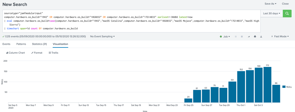

DimitriosP
Loves-to-Learn Lots
Hi @gcusello ,
if I remove (| dedup computer.pagination.id) I get results all the way back to Sep 25 the day I set up my Splunk with Jamf
sourcetype="jamfmodularinput"
computer.hardware.os_build="19H2" OR computer.hardware.os_build="18G6032" OR computer.hardware.os_build="17G14033" earliest=-30d@d latest=now
| eval computer.hardware.os_build=case(computer.hardware.os_build="19H2","macOS Catalina",computer.hardware.os_build="18G6032","macOS Mojave",computer.hardware.os_build="17G14033","macOS High Sierra")
| timechart span=1d count BY computer.hardware.os_build
But when I use your search (| eval)I only get one value null, and I don't get separated columns for each macOS build. On the other hand, when I use (| rex) I get the macOS Build separately
thank you in advance
gcusello
Hi @DimitriosP,
Ok you solved problem 1
fpr problem 2, you should see the values in computer.hardware.os_build before timechart and eval.
Please make s mad test:
| rename computer.hardware.os_build AS os_build
| eval os_build=case(os_build="19H2","macOS Catalina",os_build="18G6032","macOS Mojave",os_build="17G14033","macOS High Sierra")
| timechart span=1d count BY os_build
Ciao.
Giuseppe

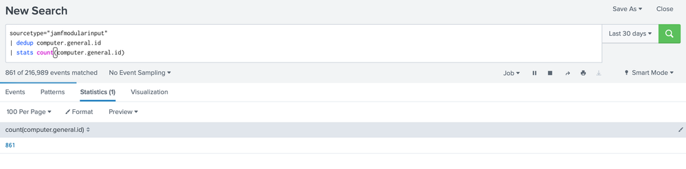

DimitriosP
Loves-to-Learn Lots
Hi @gcusello ,
Unfortunately, problem one is not resolved as in the time chard for today I get 125 computers when I should only get 43, I think there are duplicate resaults.
That's why I used (| dedup computer.pagination.id) to get only the actual computers
for example:
| dedup computer.general.id
| stats count(computer.general.id)
I get 861 computers
If I run:
I get 3440 computers
unfortunately for some reason (| dedup computer.general.id) do not seem to work on timechart
Thank you in advance

DimitriosP
Loves-to-Learn Lots
Hi @gcusello ,
Here are the two searches, I have changed the time to 30 days.
The 861 is the correct one.
I'm not sure how to insert index
D
gcusello
Hi @DimitriosP,
with the 861, you always have 1 as result of the count.
Anyway, my hint is to add index in the main search, e.g. index=wineventlog, sourcetype =Security
Ciao.
Giuseppe

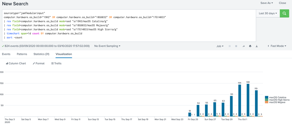

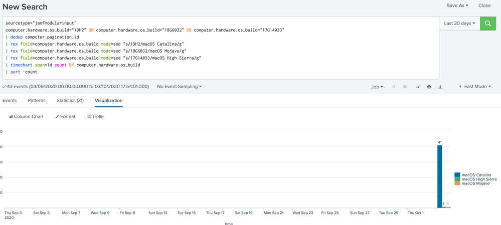

richgalloway
Two things need to change.
1) The time picker is set to 24 hours, which means Splunk will only look at data from the last day.  Change it to "Last 30 days".
2) The span option in the timechart command groups the events into "buckets".  "Span=30d" says to make each bucket hold 30 days of data, which may not be what is desired.  Try | timechart span=1d count by computer_hardware.os_build to see the number of upgrades on each day of the month.
DimitriosP
Loves-to-Learn Lots
Hi richgalloway,
Thank you for your quick response 🙂
I followed your instructions,  changed the time picker to 30 days  and span=1 that worked
but still don't get any results for older days
I removed "| dedup computer.pagination.id" if I'm not mistaken search unique computers based on ID
When removed I get results from older dates
This is what I should see
D
