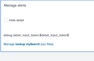

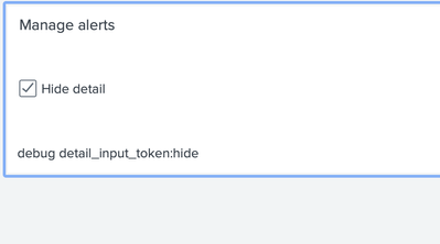

kamlesh_vaghela
@mclane1
The checkbox behaviour  working for me on Splunk Version: 8.2.2.1.
It that anything specific which not working?
