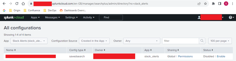

I mistakenly cloned an alert to the "Slack Alerts" app instead of the normal "Search & Reporting" app.
This alert is functioning and sending Slack messages when triggered. But the alert is in the wrong app.
But worse is that the alert now appears in the "All Configurations" page.
I am able to disable the alert but not able to remove it and I really need to remove it from the "All Configurations" page. I'm also not able to edit the alert in any way.
Is it possible to remove the alert from the "All Configurations" page?

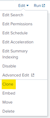

otherway is go to searches reports and alerts from settings
from their click on edit alet and clone
then you can change the app context  and , once clone the alert delete the alert with app in slack context

I feel there is not direct way to change the app context in UI also you are using splunk cloud.
