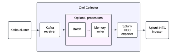

SOC4Kafka connector is built using OpenTelemetry Collector and it consists of several classes of pipeline components. The most important components for the Kafka Otel connector are: Receivers, Processors and Exporters.
SOC4Kafka building blocks
Receivers
Kafka receiver is used to fetch data from Kafka cluster. Detailed configuration of this receiver can be found under this link.
Processors
Processors are optional components that can be added to the data pipeline. They transform data before it is exported. Different processors perform actions specific to the settings of the given processor. These actions include batching, filtering, or dropping the data and more. More information about processors can be found under this link.
Exporters
Splunk HEC exporter is used to send data to the Splunk HEC index. Detailed configuration of this exporter can be found under this link.
