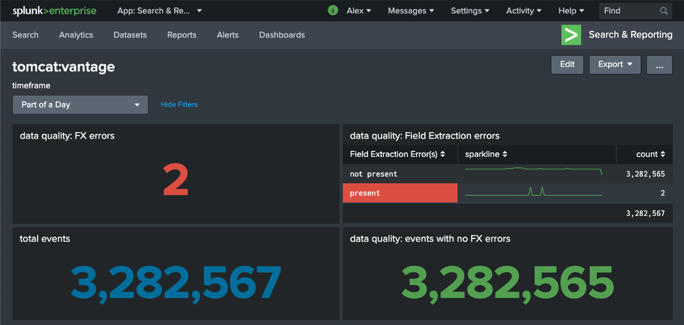

Possible to use the results of the same search in multiple panels on the same dashboard, and with different visualizations for them? (By the "same search" I mean: run it once, present results in several places via different means.)
Reason: make it faster, use less resources.
Example:
data quality dashboard
All four panels of the above dashboard use basically the same search that checks if a field message was extracted, and reports the stats highlighting the number of events where that field is not present.
Notes:
- Field message should be present in all events; if it's not - it's a field extraction error.
- The error is not necessarily the result of a bad field extraction regex - it could also be the result of a malformed event, event breaking too soon, etc.
- The top right panel is all that is needed - yet the other panels do help - I'd like to keep them there - although not at the expense of running multiple redundant searches.
The search:
sourcetype="some_sourcetype"
| eval "Field Extraction Error(s)" = if(isnull(message),"present","not present")
| stats sparkline count by "Field Extraction Error(s)"
Possible?

Yes, it's possible. It's also common and recommended. Splunk calls it "post-processing" and you can read about it at https://docs.splunk.com/Documentation/Splunk/8.0.3/Viz/Savedsearches#Post-process_searches_2
