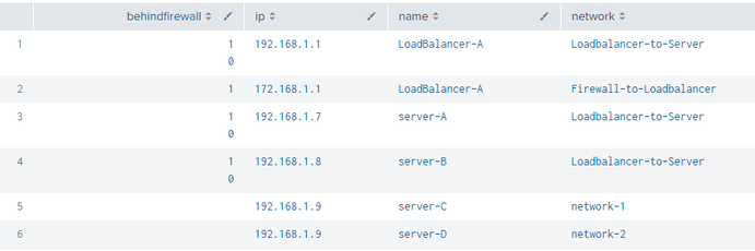

LearningGuy
Motivator
Hi @bowesmana
I ran your example. When the lookup used in the search, "behindfirewall" field contains both 1 and 0.
So, I can use if condition:   if behindfirewall contains 1, then the hostname is behind the firewall, correct?
Thanks for your help
firewall.csv
after the lookup
bowesmana
Yes, you can just say
| eval behindfirewall=max(behindfirewall)
however, I am not sure if that will totally work, because if something in my example is attached to LoadBalancer-B, then it will assume it's behind the firewall, so not totally sure if my suggestion is valid
