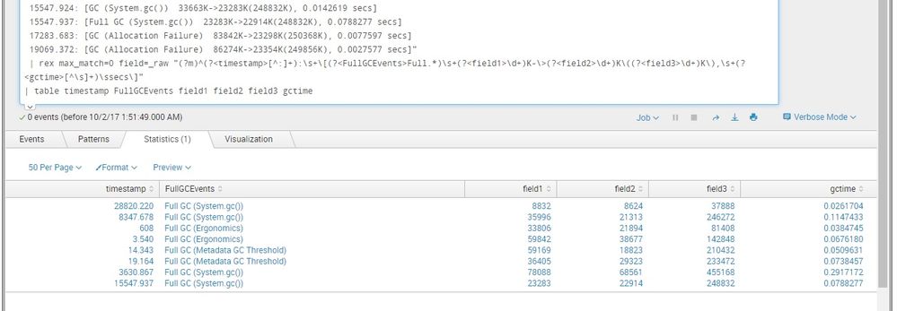

Here is the image values when I run the below query...but the goal is on x-axis needs to show the timestamp and y-axis the duration with line graph when hover both the timestamp and duration has to show as per the below image. Now this is showing the max values...but has to show all the values
rex max_match=0 field=_raw "(?m)^(?<timestamp>[^:]+):\s+\[(?<FullGCEvents>Full.*)\s+(?<field1>\d+)K-\>(?<field2>\d+)K\((?<field3>\d+)K\),\s+(?<gctime>[^\s]+)\ssecs\]" |  chart max(gctime) as Duration by timestamp

@inventsekar: Thanks for the regex...it works fine.
would like to show a trend chart for the Full GC events with values of timestamp in x-axis and gctime at y-axis..kind of line chart...I know some stats functions we have to use here but how to populate the actual values of timestamp and gctime and show the graph
| rex max_match=0 field=_raw "(?m)^(?<timestamp>[^:]+):\s+\[(?<FullGCEvents>Full.*)\s+(?<field1>\d+)K-\>(?<field2>\d+)K\((?<field3>\d+)K\),\s+(?<gctime>[^\s]+)\ssecs\]" |where like(serv1,"%serv1%") |  chart values(gctime) as gctime by timestamp
timestamp:
28820.220
8347.678
11947.797
gctime:
0.0261704
0.1147433
0.1237187
serv name from the filename which is source
maybe, the timestamp need to be converted first (strptime/strftime).
nagaraju_chitta
I am not getting the chart only in the x-axis the values of timestamp are populating. my requirement is I no need to convert the time as I have to display the as is of timestamp and gctime...somehow could not be able to attach image
