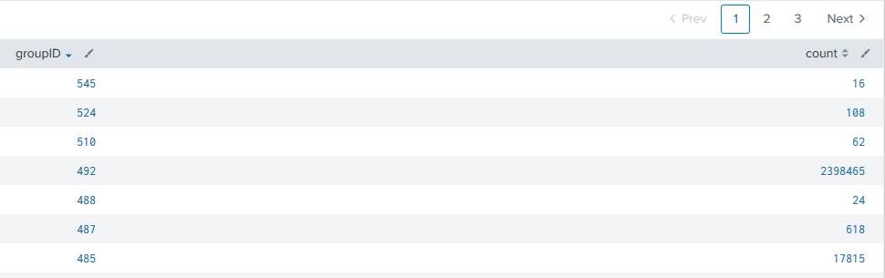

So Here is a little follow up, as i am still not able to get any results:
These are the results without the 'where' clause:
index=my_index sourcetype=my_sourcetype
| stats count by groupID​
So e.g. there are 2398465 Events for the groupID 492.
