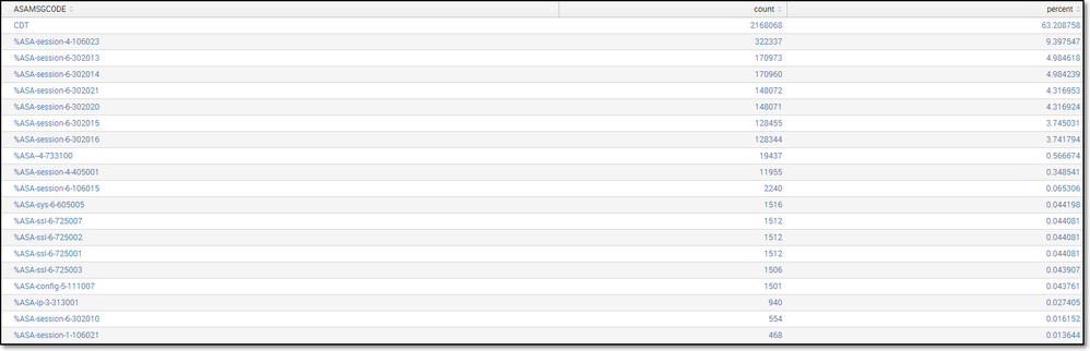

Having issues getting field extraction on Cisco ASA lines to work consistently without getting invalid information. Field extraction generates the following regex:
"^(?:[^ \n]* ){8}(?P<ASAMSGCODE>[^:]+)"
The events that are skewed report the value as CDT. When the field extraction is performed on this set of events, the regex is:
"^(?:[^ \n]* ){9}(?P<ASAMSGCODE>[^:]+)"
It appears to be counting spaces. The example where {8} is has a single space between the Aug and the 10, where the {9} has a double space between the Aug and the 9. I have attempted several manipulations on the regex without success.
Example where {8}
Aug 10 11:07:10 #.#.#.# :Aug 10 11:07:10 CDT: %ASA-session-4-106023: Deny icmp src devicename:#.#.#.# dst inside:devicename (type 8, code 0) by access-group "aclname" [0x0, 0x0]
Example where {9}
Aug  9 23:59:58 #.#.#.# :Aug 09 23:59:59 CDT: %ASA-session-4-106023: Deny tcp src devicename dst outside:devicename by access-group "aclname" [0x0, 0x0]

I am looking to extract the ASA message code values (ex. %ASA-session-4-106023) to generate table like the original attached image. The #'s were numbers that I sanitized from the log line.
