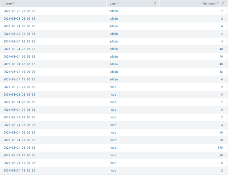

I want to know how I can incrementally go through and add missing times (hours) per user across a number of users.   Also the fail_num for those times should be '0'.    I've thought of using foreach, but I'm not sure this is the route to go here.
Above is a result showing only 2 users from the query I'm making in one of my previous posts ("Detecting-Spikes-Anomalies-in-Failed-Logins-over-time").
For cases where the fail_num was 0 no entry was made and therefore I have no row for that timeslot.  When I use trendline to analyze this it won't work because it doesn't have enough points of data to compute the moving average.  I cannot use timechart to do this.
So, if there is a more programmatic way to add rows that are missing in by using regex or some more efficient method, then someone please enlighten me on this. I can't use timechart to fill these in because it breaks other things in my query.   I've thought of using foreach, but I'm not sure this is the route to go here.
If you're wondering why I can't use timechart it makes it impossible for me to do the analysis unless 3d dimensional analysis or something exists in Splunk...sadly I'm not mathematically or programmatically gifted enough to think up such a solution.

I'm not sure what the user field here means but I'd try something with gentimes.
Something like:
<your_query>| append [ gentimes start="2021/08/21:10:38:00" end="2021/09/21:10:38:00" increment=1h
| fields starttime
| rename starttime as _time
| eval fail_num=0
| eval user="root" ]
| stats sum(fail_num) as fail_num values(user) as user by _time
PickleRick
OK. It wasn't clear from the original posting what you're doing with the users (there were uniqe time values so I assumed the users were non-overlapping).
If you mean that for every user you can have a separate sequence of dates, instead of | eval user="root" you can do
| users=mvappend("user1","user2","user3"...) | mvexpand users
(of course you'd add | eval fail_num=0 after that)
Then at the end you'd stats not by _time but by _time and user.
Is this more what you need?
