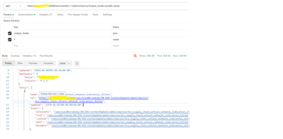

manish_navi
@richgalloway
I have already tried using this if you see my posted questions , there i have already mentioned that filters parameter f , is not working .
here is the screenshot if what i tried
