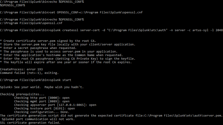

I have a problem with one of our Splunk installations on Windows. The server certificate is expired and I'm unable to renew it. I've tried renaming C:\Program Files\Splunk\etc\auth\server.pem and restarting Splunk, which ends with that:
The certificate generation script did not generate the expected certificate file:C:\Program Files\Splunk\etc\auth\server.pem. Splunkd port communication will not work.
SSL certificate generation failed.
And I also tried this command: C:\Program Files\Splunk\bin>splunk createssl server-cert -d "C:\Program Files\Splunk\etc\auth" -n server -c *servername*
Which also fails with this:
CreateProcess: error 193
Command failed (ret=-1), exiting.

Hi there,
thank you for your idea, but unfortunately it was not working:
The path is correct. Is there any way to find out, why the generation is failing? Checked some logs, but couldn't find anything that was helping...
