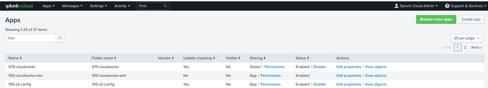

Yes, but I don't have "Uploaded Apps" tab. My Manage Apps screen looks like this Screenshot 2021-05-25 at 19.47.58.png
richgalloway
I believe Splunk Cloud is in the process of changing the Manage Apps interface.  I described the old interface, but you have the new one. I don't know why you don't have a button to install your own app.
