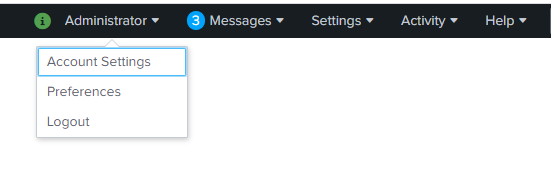

so you have a login form where you have to enter your username and the password and a user preferences menu on the top, which should usually contain three options: Account Settings, Preferences and Logout. All of them are present except of Logout option?
