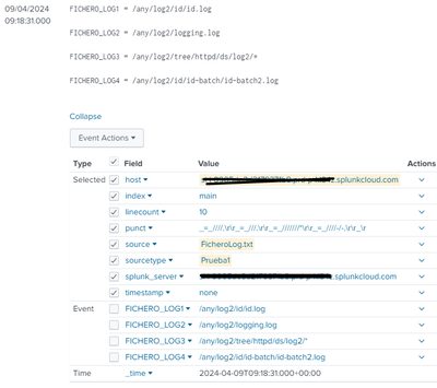

Be_JAR
this is the result:
I would expect a LOG field to be created for each event with the different values of its log1, log2, or logn.
Regular expression works (tested on 101), and other_transforms_stanza does not apply to this field.
richgalloway
I also expected the LOG field to be extracted.  Were the changes to props/transforms installed on the first full Splunk instance the sees the data?  Was that instance restarted?  Is the screenshot showing new data (since the restart)?
