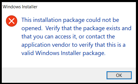

when I run the command as : msiexec.exe /i C:\Users\Desktop\splunk-8.2.2-87344edfcdb4-x64-release.msi
I get this error.

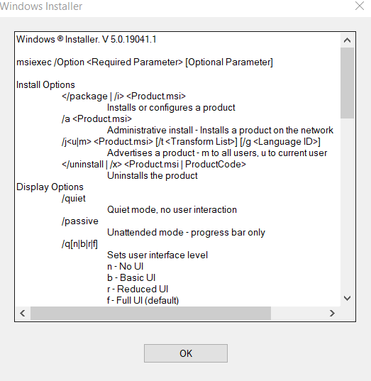

Then i checked the services for the windows installer  i have started that and then used this cmd command it get this.
After pressing Okay nothing happen.
Not sure what is wrong.

I get the error as " This installation  could not be opened.
I have attached the pic for the reference.
