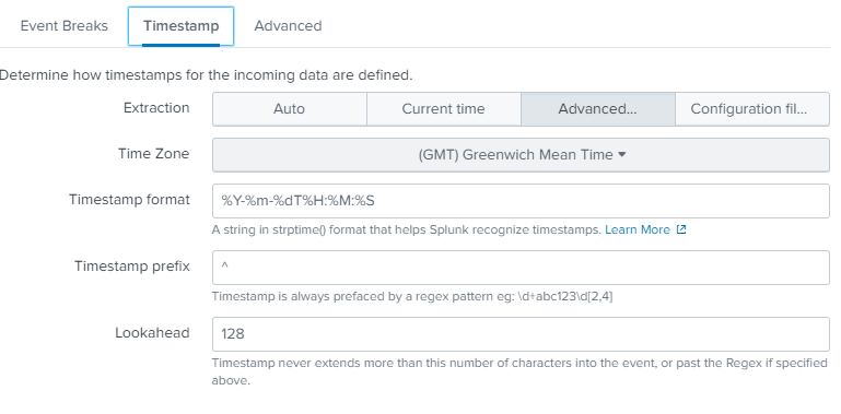

So I decided to change the timestamp format to exclude the -05:00 and also change the time zone and that worked.
Timestamp format:  %Y-%m-%dT%H:%M:%S
Time Zone:  GMT
Thanks for the help!
