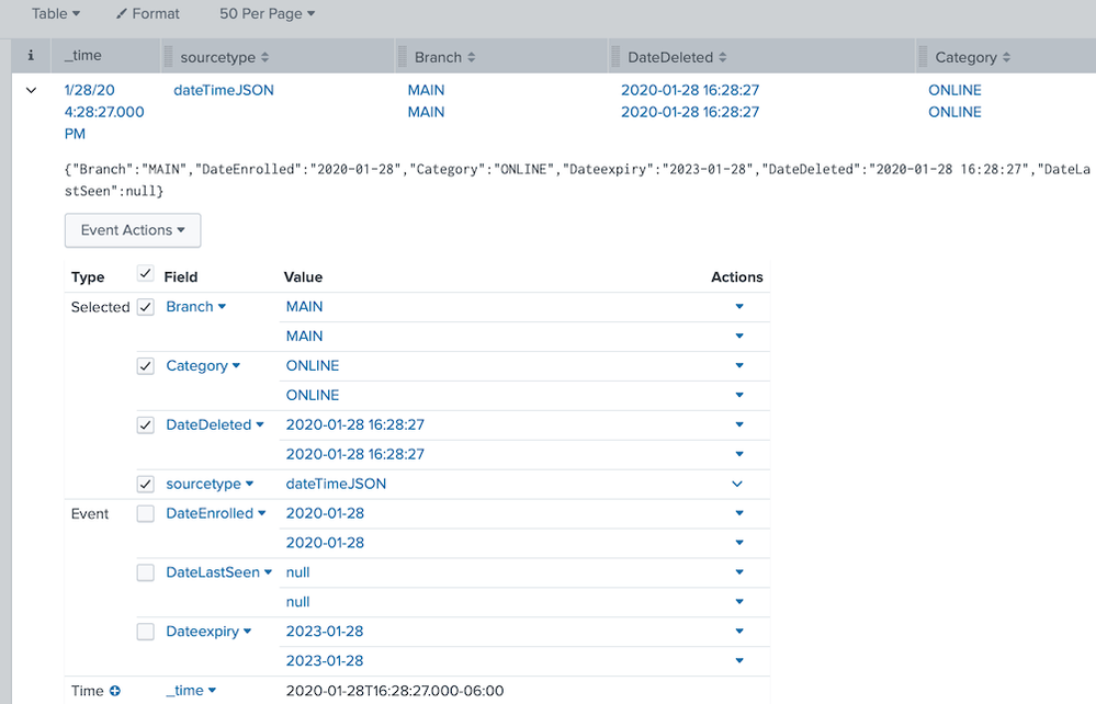

We've been acquiring data for some time now via manual imports with CSV files. We're finishing up the process of automating that by importing JSON on a cron schedule. So far, it's been going simply great. Today, we hit a snag.
We have a source that has multiple date or date-time fields in it, so in order to ensure we get the right field to be used as the timestamp, we created a new sourcetype called dateTimeJSON that specifies the TimeStamp field as "DateDeleted", the field we're looking for.
If we search the index, we see the data and the correct number of event counts (13 in this test case). However, when we look at the data in a table, each field has two values in it -- this results in double the results in all of our searches and dashboards. Here's what we see from a search as simple as "index=koha_dcards":
What the heck can even cause something like this? How do we rectify it? All of our other indices and data inputs have never had a problem like this, and we've had to spec fields in the sourcetype before without issue.
I'm gobsmacked...

Would this setting have any pertinence? Should it be "none" instead of "json"? Will that accomplish the same as setting the AUTO_KV_JSON, but for this one sourcetype only?

You can certainly try to set indexed extractions to none. That may affect other things you are configuring though, like the Timestamp fields. Because if you don't have those fields when the data is ingested into Splunk, you probably can't reference it like you're doing now as the timestamp field. Indexed Extractions is sort of an easy button for parsing data (getting data into Splunk)
The other option would be to set the auto kv json setting to false for this sourcetype in props.conf. This would just turn off the extractions that try to run at search time.

not sure if something is different with 8.x, but this typically means that KV_MODE=json is set for this sourcetype somehow. So you the fields get indexed with indexed_extractions setting but then also extracted at search time with the kv_mode setting.
maybe at least rule it out with btool on your search head??
splunk btool props list dateTimeJSON --debug
And if not set on the sourcetype, maybe make sure it's not set in props for the source/host either?

Yeah, i would suggest setting AUTO_KV_JSON=false for your sourcetype as well.
From the docs....
AUTO_KV_JSON = <boolean>
* Used for search-time field extractions only.
* Specifies whether to try json extraction automatically.
* Default: true
