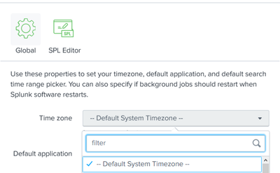

And also confirm what your user timezone is within the interface:

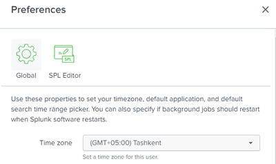

The time zone preference set in Splunk User Preferences is below
