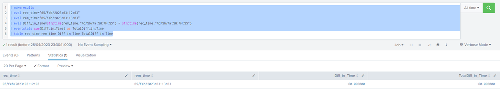

Hi @Souletting ,
Here, in the following search, I am taking an example by makeresult command, for verifying the above search,
| makeresults
| eval rec_time="05/Feb/2023:03:12:03"
| eval rem_time="05/Feb/2023:03:13:03"
| eval Diff_in_Time=strptime(rem_time,"%d/%b/%Y:%H:%M:%S") - strptime(rec_time,"%d/%b/%Y:%H:%M:%S")
| eventstats sum(Diff_in_Time) as TotalDiff_in_Time
| table rec_time rem_time Diff_in_Time TotalDiff_in_Time
The output of the above search is as follows,
So, the search seems to be working fine, the issue seems to be in the time-format used in your search.
Kindly upvote if found useful.
Happy Splunking!
