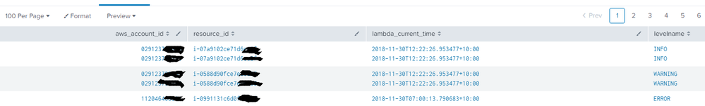

when I open the event, it shows duplicate values:
When i try and create a table:
| table aws_account_id, resource_id, lambda_current_time, levelname
I also get duplicates in my row:
No idea what is going on?

Hi justins777,
check the props.conf for the sourcetype and validate that you either use :
INDEXED_EXTRACTIONS = JSON on the parsing Splunk instance (eq indexer or heavy weight forwarder)
OR
KV_MODE = json on the search head.
Don't use both settings at the same time.
Hope this helps ...
