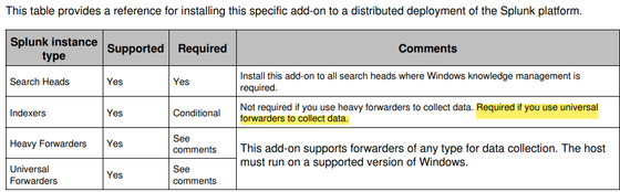

I have tried to deploy the Windows-TA Add-On over my environment [Search Head Cluster + Deployer] [3 Indexer Peer + Indexer Cluster Master] [Deployment Server + Universal Forwarder].
I have used the Deployment server to push the inputs.conf to the designated universal forwarder which allocated on the domain controller server and enable the needed.
then remove the wmi.conf and inputs.conf from the Windows TA-Add-On, and copy the rest to local folder and used the deployer to push the enhanced Windows TA to the search heads.
As per the below screen from the official doc the indexer is conditional:
Why should push the Add-on to the indexers even if there are an index time field extraction?
As i am know the search head cluster will replicate all the knowledge bundle with the indexers so all the KOs will be replicated to the indexers and no need to push them, am i correct?
Splunk Add-on for Microsoft Windows
Thanks in advance!!

That the knowledge bundle is replicated to the search peers is correct but for the parsing (e.g. timestamp extraction) during indexing only the configuration from $SPLUNK_HOME/etc/peer-apps is used as a source. So that's the reason why you must deploy the TA on the indexer if it is no HeavyForwarder inbetween.
The knowledge bundle is used during the searching.
