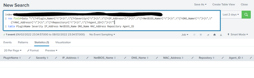

Hi @gcusello
Somehow it is still not working. It is not showing the results in the table:
gcusello
Hi @svenrieder,
this means that somehow there's some difference in the log format, you have to identify these differences and modify the regex used for the extractions.
If you could identify the events with different logs and share them I could help you in regex update.
Ciao.
Giuseppe
