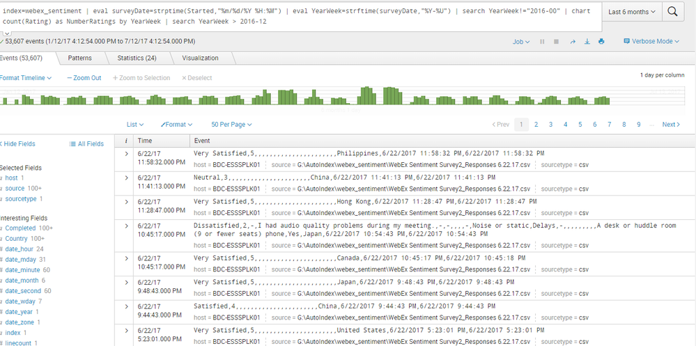

I began digging into the original CSV files before they are uploaded into Splunk.
Here is the picture again of the duplicated Hungary events in Splunk: http://imgur.com/a/IDYFD
Looking at these events, it seems there are three duplicates at 10:57 on April 28th.
However, the raw CSV for April 28th has three events at 10:57, but only one is from Hungary: http://imgur.com/a/KC63m
Here is the entire raw CSV file for April 28th (the time fields are on the far right):
https://app.box.com/s/tpljxe8500aegkdasgx1ghhcl3rao5sa
I'm not sure what this means - perhaps the countries are being read incorrectly?

Aha I've found the files!
Here you can see the index.conf for the webex_sentiment:
http://imgur.com/a/K3Yb4
I believe I need to delete all the data that exists in the index currently, then re-upload with this new sourcetype:
http://imgur.com/a/NbHIU
This new timestamp will correct for the 17 to 2017 problem.
However, with yours and @mmodestino's help I've realized there is a bigger problem with data integrity.
Though the headers appear in the right place in the CSV format, when opened in Notepad I think there are some extra commas or something.
This screenshot shows the problem when Splunk tries to ingest the data: http://imgur.com/a/jFv7Z
The error for event 33 reads:
Could not use strptime to parse timestamp from "Yes." Failed to parse timestamp. Defaulting to timestamp of previous event (Wed Apr 26 03:37:00 2017).
There is text that should not be there appearing in the time fields...
I believe the problem is with the data we are receiving from Cisco.

Time stamp might be workable, if it goes down to the second.... Hmmm. No, from the data, start and stop are the same time, which makes it highly unlikely that the timestamp has to do with the call. It's probably the timestamp for submission of the questionnaire.
So, your data is pretty useless as far as triaging individual calls.
On the plus side, Country is there in the data, capitalized. You can run the query again with the required capitalization and maybe you'll be able to see something. Kill the last two lines of the country query until you've seen if you have an actual spike that's Country related.

I input your suggestion like this:
index = webex_sentiment
| eval surveyDate = strptime(Started,"%m/%d/%Y %H:%M")
| eval YearWeek=strftime(surveyDate,"%Y-%U")
| search YearWeek!="2016-00"
| bin _time span=1d
| stats count as daycount by country _time
| eventstats avg(daycount) as avgcount stdev(daycount) as stdevcount by country
| where daycount> avgcount + 3*stdevcount
| chart count(Rating) as NumberRatings by YearWeek
| search YearWeek > 2016-12
I received these events back: http://imgur.com/a/8XYvW
However, there is no subset by country visualization: http://imgur.com/a/pNIuu

What we need to do is to help Splunk with the time format, as the auto extraction is letting you down.
Can you paste a few of these raw events from this screenshot here so I can run them through the Add data wizard for you and help you build a better timestamp extraction?
Ideally we will use timestamp_fields and a time_format like %m/%d/%y %k:%M
This demonstrates a best practice that states we should always build our props to define how to extract where to find the timestamp, how to process it's format, ,among other golden rules. The add data wiz is really great for that.
- MattyMo
