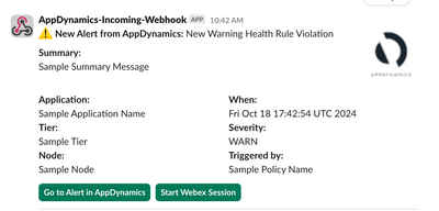

  6. Test the template configuration. Click the Run Test button on the bottom of the page and choose some events to send over.
    image.pngThe HTTP Action Template Test
  7. Navigate to the Slack channel you set up. You should see a sample alert, like the “New Warning Health Rule Violation” shown below.
image.pngTest Health Rule violation warningng

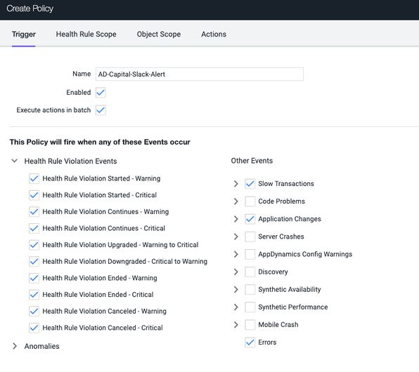

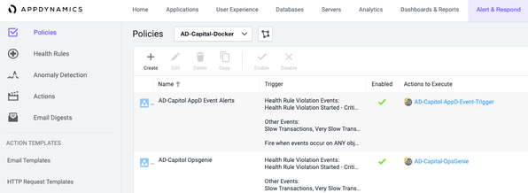

Create a policy
Next, create a policy that both triggers the outbound HTTP request action, and binds the action to a particular application.
  1. From the Actions and Alerts option, select Policy, then click Create a New Policy. Select the desired application.
    image.pngCreate the new policy screen
  2. Click the Create button. Name the policy, then configure which events will trigger this alert.
    image.pngSee the example of how one might configure the policy
  3. Next, go to the Actions tab on the top menu and select the “+”. From the list, choose an action to tie to this Policy, then click Save.
    image.pngUnder Actions, choose an action to tie to the policy
Now, you have configured a Policy on an application to trigger an action, which then uses the template to send an event or alert (based on the rules you set in the policy) to a particular Slack channel.

Once your application starts generating policy violations, you’ll see them in your AppD-Alerting Slack channel as shown below.
image.pngExample of the policy violation notice in Slack
The alert has two buttons. One takes you to the deep link URL in AppDynamics where the alert was generated. You can use the second button to log in and start a WebEx session if needed.

Hi Jeevanjyoti,
Can you run the test from the template and does that work and show up in slack? The test button is in the lower right hand corner of the Alerting Template next to save.  First make sure you can get this test mode to work.
It should produce this in slack
To Trigger an alert from an application you need to have a Policy set against a health rule that will trigger the action that consumes the webhook template that points to the Slack Webhook URL.
I know this works, I recently set it up again and it works just fine.
Health Rule Violation -> Policy -> Action -> Webhook payload sent to Slack Webhook URL.
The Policy connects the HR violation to the Action you want to take, webhook, email ... and more.
