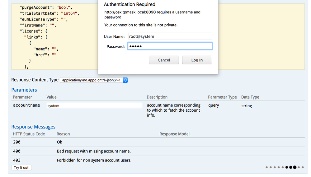

I'm just trying  to follow the above mentioned URL... logged in to the controller with a local user name, tried to access REST API via browser as stated in the doc, however it does not allow me to  use 'GET' , it pops up another authentication window and fails with response code 500 (see attached), if i use the same username, password that i used to access controller UI

Hi Sundarapandian,
The API "/accounts/accountinfo" is for only for system account. We need to login as root@system with the root user password.Do refer the attached screen for your referance.

 Hi Sundarapandian,
Form the attached screenshot we noticed following message "The user is not authorised to access account:81". Could you try to get the your user account id through GET (/accounts/myaccount) refer the attached screenshot and then use the account id returned to get applications (/accounts/{accId}/applications).

Hi Pratik,
Thanks for you response, you are correct!, the account id that i see from /account/myaccount is different, i tried with that id and i could GET /accounts/{accId}/applications, however when i tried /accounts/accountinfo it failed with response code 403 (see attached). Any reason?

Hi Sundarapandian,
