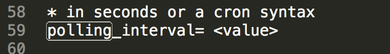

It's very easy , the setup screen is even documented for you.
The polling interval can be either 1) a cron expression or 2) a polling interval in seconds

There is no externally configurable polling_typeparameter in the REST Mod Input.
There is only polling_interval
The App automatically determines if this field is an integer or a cron pattern, sets an internal variable to indicate the type of polling and then executes the polling loop accordingly.
If the polling_interval parameter is left blank , then it defaults to 60. So will poll your REST endpoint every minute.
