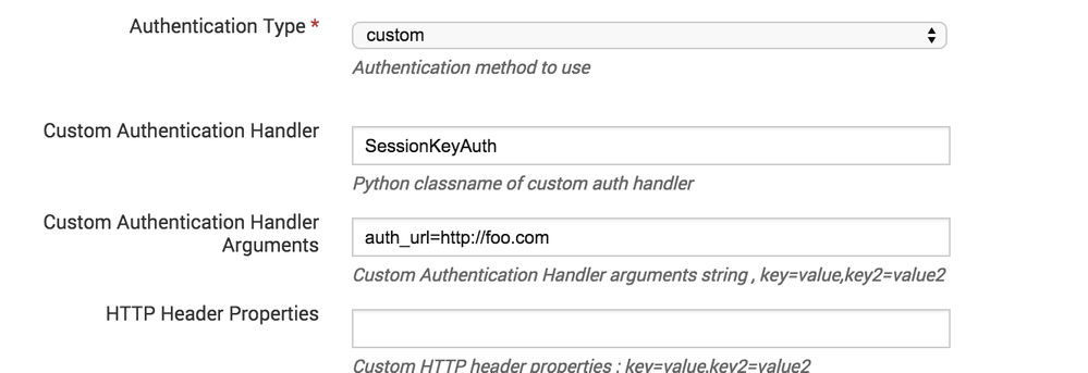

If my above assumption/guess is correct , then you could try a custom authentication handler like below.
Note , this is purely untested example code to refer to , tweak it as you see fit to make your flow work.
Add the code to rest_ta/bin/authhandlers.py. Then wire it up in your REST stanza.

david_rose
Communicator
Thanks for your help Damien! I threw the response_json into a file and saw it was showing unsupported content. The following code works:
 def __call__(self, r):
                if not 'X-HP3PAR-WSAPI-SessionKey' in r.headers:
                #perform auth
                        credentials = {'user':'user','password':'password'}
                        req_args = {"verify" : False}
                        headers = {'content-type': 'application/json'}
                        auth_response = requests.post(self.auth_url,data=json.dumps(credentials),headers=headers,**req_args)
                        response_json = json.loads(auth_response.text)
                        session_key = response_json["key"]
                        r.headers['X-HP3PAR-WSAPI-SessionKey'] = session_key
                return r

Damien_Dallimor
Ultra Champion
something like :
#perform auth
 auth_response = requests.post(self.auth_url,**req_args)
