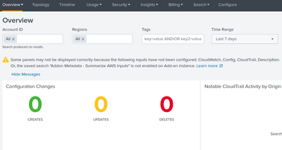

I have Configured AWS add-on in Heavy Forwarder and AWS app in Search Head but not displaying AWS app dashboared
Dhanaskv
I have Configured Distributed Splunk Setup AWS add-on in Heavy Forwarder and AWS app in Search Head but Configuration changes not displaying AWS app dashboardScreenshot from 2021-03-15 10-26-37.png

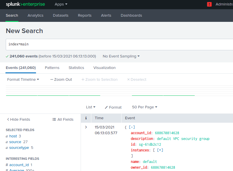

Dhanaskv
Thanks for your response
Whether logs are coming to index? 👇
Yes @Vardhan
the default config of the app is anywhere mentioned the index name in macro or event type?
@Vardhan  default config (In Search Head Where AWS app Deployed) means I believe this 👇
Vardhan
Contributor
Hi,
Please check in macro.conf is there any other index name is mentioned.
And also in the below screenshot shows the warning like the required inputs has not been configured. You may get the data from the aws.But that data may not be useful for the app.
So enable the below mentioned inputs in the hf and get those logs to the index.

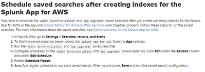

Dhanaskv
Yes @Vardhan
but the fifth step  can't find out
