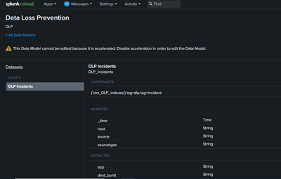

Even after dlp data is added to the dlp datamodel, I didnt see any dlp incidents in the datamodel, what could be the problem here ?
Thanks
gcusello
in the screenshot you shared there's the Data Model's structure, you don't see any data.
To see Data Model data you have to use it in a search
| datamodel DLP_Incidents
If you haven't data, run the constraints search to see id you have correctly tagged data.
Ciao.
Giuseppe

In fact this is the correct search
| datamodel DLP DLP_Incidents
I can see only the 1 event no fields 😞
richgalloway
One event is a start.  It means the event is tagged correctly.
The next step is install one or more TAs to extract fields from the data.  Then ensure the data uses CIM field (if the TAs do not do that for you).
