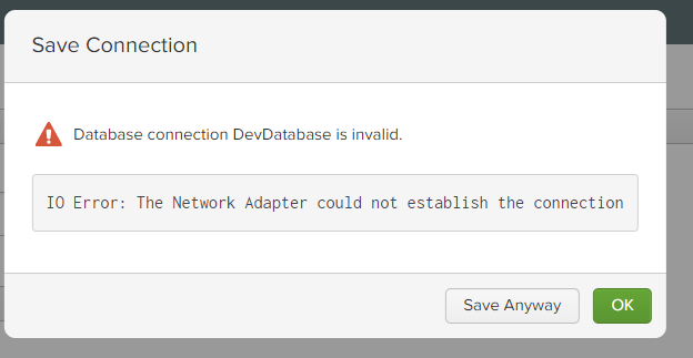

I am trying to use the Splunk DB Connect plug-in: https://splunkbase.splunk.com/app/2686/#/details. I have configured the JRE, the JAR for the JDBC connection (Figure 1), the identity with the username and password for the connection. However on the screen where I test the connection I always receive an I/O error, Figure 2. So this tells me that the connection is not working. 😕
Is there some type of log I can check to try and pinpoint what is going wrong? I thought maybe there was a firewall issue but I can ping the computer the database is on. I thought the issue was with the JRE but I uninstalled the openjdk JRE from the operating system and installed one from Oracle dot com. I thought maybe the issue was with the "Connection Type" on the "New Connection" screen but the connection fails whether I specify "Oracle" or "Oracle Service".

Figure 1: JDBC URL Settings
Figure 2: IO Error: The Network Adapter could not establish the connection

richgalloway
Check your firewalls as possible timeout causes.
Splunk monitors its own logs by default so you shouldn't need to set up anything.

rogue_carrot
Communicator
Yes, I need to fill out a firewall request form in my organization. This is a firewall issue indeed. Thank-you for the help with this Rich.

richgalloway
DB Connect has its own set of log files. Search "index=_internal sourcetype=dbx*".
Ping is not a good indication of the ability to connect to a service. Try using telnet or curl as they let you specify a port as well as an address.
Make sure the Oracle version is supported by DB Connect.
rogue_carrot
Communicator
Hello Rich!
Thank-you sir for the reply. I noticed this Linux machine does not have the telnet program so I am using the curl program. I received a time out connection error when trying to curl to this database server. 😕 Thank-you for the idea on how to trouble shoot this problem with the curl program. Now if I could figure out why there is a timeout error.
