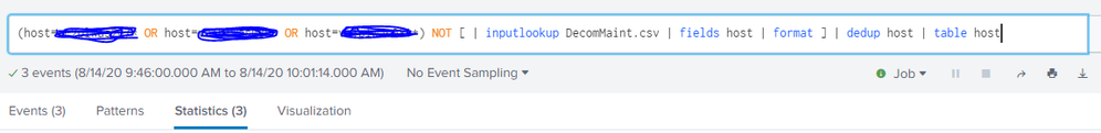

I tried something below and mentioned only one hosts in the csv file but still i found the events for that host as well.
Kindly let me know is there anything i need to modify/update in this query.
host=host1* OR host=host2* OR host=host3* NOT [ | inputlookup DecomMaint.csv | format ]
richgalloway
Use of parentheses may help.  Also, the field name returned from the subsearch must match a field name in the main search (or use rename to make them match).
(host=host1* OR host=host2* OR host=host3*) NOT [ | inputlookup DecomMaint.csv | rename foo as host | fields host | format ]

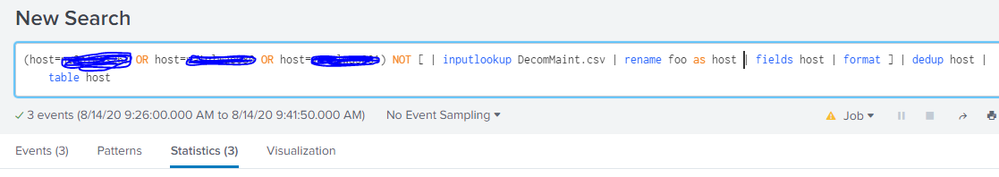

@richgalloway - Apologize for the delay , i tried with 3 hosts in the query and added only one host in the CSV file but still it's returning for that host as well. Kindly help
richgalloway
Can you share your CSV file? Does it have a field called "foo"? If not, change "foo" to match the field name in the lookup file.

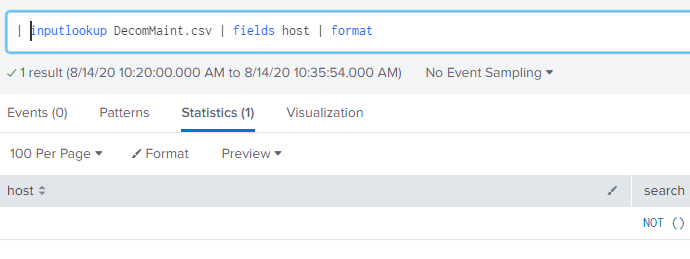

What results do you get when running the subsearch ("| inputlookup" through "format") by itself?
sureshkumaar
@richgalloway i tried the query "| inputlookup DecomMaint.csv | fields host | format"
richgalloway
Thank you. That output tells me there is no "host" field in the lookup file. Again I ask you to kindly share the lookup file (change host names, if necessary).

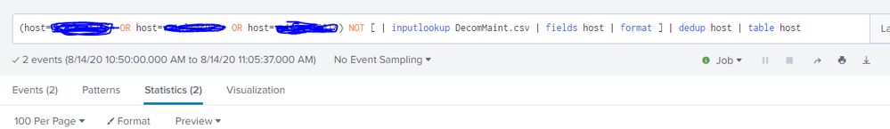

sureshkumaar
@richgalloway   - It's my BAD, in the lookup table "Destination filename" i updated without file extension ".csv" after typing file name with it's extension. It worked now successfully
