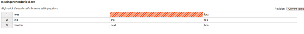

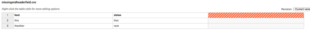

Sorry to add another answer; but here is how you do it if your not on Linux or do not have OS access on the search head to run @woodcock 's command.
Using the Lookup Editor App https://splunkbase.splunk.com/app/1724/ you can check the lookup files and see the error straight away!
I uploaded two lookup files called missingoneheaderfield.csv which is missing one header field somewhere in the header and another lookup file called missingendheaderfield.csv which - surprise, surprise - misses one field at the end of the header.
Running the app and looking at the lookup files you can spot and fix the errors very easy.
Hope this will help anyone out there to get rid of this annoying error
cheers, MuS
