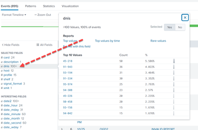

distinct results in splunk and how to show all data in selected fields vs the 100+ results
kiran_panchavat
@jmunsterman  As mentioned @richgalloway  , you can use the stats command to retrieve all the results. Please find the attached screenshot for reference.

kiran_panchavat

richgalloway
One way to see all 100+ values of the field is by using the stats command.
... | stats count by dnis
 Of course, the table command also will list all values of the field (with duplicates, if any).
... | table dnis
