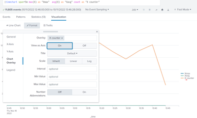

I experienced that the chart overlay is buggy when there are spaces or special characters in the name (though I did realize this effect only in the search, on the Dashboards it worked also with spaces. Splunk v 8.2.3.3). When I removed the space in the field name, the value could be plotted as secondary axis with overlay. Try to remove your brackets by renaming avg(Time).
Anonymized example:
Attempt with space in field namedoes not work. The overlay is ignored and no secondary axis:
Attempt without space in field name works properly:
