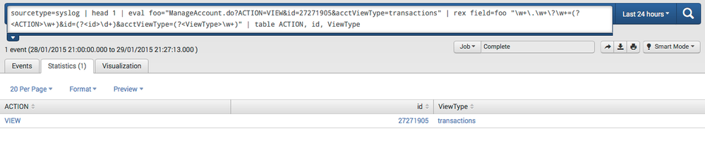

Hi kknopp,
I don't see any problem, maybe you need do use some capturing group in your regex like this:
sourcetype=syslog | head 1 | eval foo="ManageAccount.do?ACTION=VIEW&id=27271905&acctViewType=transactions" | rex field=foo "\w+\.\w+\?\w+=(?<ACTION>\w+)&id=(?<id>\d+)&acctViewType=(?<ViewType>\w+)" | table ACTION, id, ViewType
I used this on splunkstorm and it works perfectly - producing a result like this:
The sourcetype=syslog | head 1 | eval foo="ManageAccount.do?ACTION=VIEW&id=27271905&acctViewType=transactions" part is only to generate your event data, so you will not need to do it....simply do something like this:
your base search here | rex "\w+\.\w+\?\w+=(?<ACTION>\w+)&id=(?<id>\d+)&acctViewType=(?<ViewType>\w+)" | table ACTION, id, ViewType
cheers, MuS
