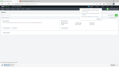

Hello, I am stuck, this error message keeps appearing, so I cannot run any searches, they just get queued up.
It has rendered my Splunk instance as unusable?

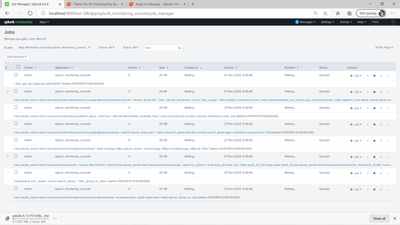

Hi,  @isoutamo  @impurush I cannot even run my monitoring console as the reports are all being queued.
But I cannot see any alerts in searches reports and alerts, and I also don't have an Administrator button.
I have attached a screenshot of the reports that are being run. I deleted these yesterday but they are back up and running today, very confusing as I am not running them.
Thanks a lot for your help.

Please change app to All from MC when you are looking which job there are running. Also owner etc. should be All.

When those are scheduled (etc.) it didn't help to just stop on activity screen (only for short period). And in your attached picture it's showing only jobs which are launch under app MC and seems to be a Waiting status. So there must be a lot of other jobs under other applications (for that reason select All instead of Monitoring Console for application). Then you can see what those jobs are and where you should disable those.

Hi @isoutamo  here is a screenshot of all selected, no jobs running, but when I go to the search and reporting app the error message occurs again.

Hi @isoutamo , thanks, @impurush  thanks too, I have updated my Splunk install, and error message is not showing anymore, so great thanks for your help. My search capability is back which is great.
