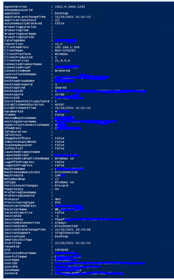

I have a powershell script running get-brokersession which then exports the results to a txt file.   The file is then forwarded via the Universal Forwarder.     Trying to create a search that bases the output data via the session key.   The Citrix add-on app is not allowed at our location.
kmm2
When we run  get-brokersession  we have a txt file with time stamps in the txt file for events.  We can not get the date and time to show up in splunk.  We can get date only or time only.   When we try to do both, the parsed data stops at a line where a  timestamp is located with no output.

The forwarder is forwarding.  The information is broken up in splunk every time it comes across a line with a timestamp.   Then a new field is created after the timestamp line until it hits another timestamp in the txt

Trying to update the props/transform.conf so that I can created fields for the items listed on the left side of the image below.
FIELD_DELIMITER=:
FIELD_NAMES=myfield1,myfield2,myfield3,myfield4
Is what I am working with and have not had success
