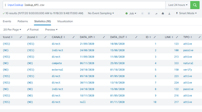

Excellent, with that data, I ... well, we'll see if this is *right* or not, but at least it's gonna be way closer.
I converted your data into a CSV file and uploaded to my system so I have a thing I can use with `| inputlookup` (I'll paste all code later, after the screenshots so you can copy/paste it if needed).
I had to fiddle a little with the date formats (not worth my effort to figure why), but then I got the new fields created.  In addition, I assigned the field `_time` to dataout, perhaps that should be set to datakpi instead.  Either way, that's left as an exercise for the reader.   Also my fields are differently named, I'm sure you'll figure that part out and correct as you want.  🙂
If you are color blind, I can do something different here but hopefully it'll come across OK.

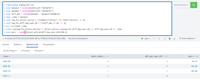

As promised, the actual code, stats one with separate evals first because that's what's on my screen right now and I'm lazy.  KEEP IN MIND that you'll have to swap out my `| inputlookup lookup_KPI.csv` command for your own search, and fix up those dates again back to the right way.  Also change field names in the "AS blah" sections.
| eval dataout = strptime(DATA_OUT,"%d/%m/%Y")
| eval datakpi = strptime(DATA_KPI,"%d/%m/%Y")
| eval diff_day = round((datakpi - dataout)/86400,0)
| eval _time = dataout
| eval sum_for_direct_attive = if(CANALE=="direct" AND TIPO=="attive", 1, 0)
| eval sum_for_diff_day_over_45 = if(diff_day <= 45, 1, 0)
| bin span=1mon _time
| stats sum(sum_for_direct_attive) AS direct_attive sum(sum_for_diff_day_over_45) AS diff_day_over_45 BY _time
| eval perc = round((direct_attive/diff_day_over_45)*100,2)

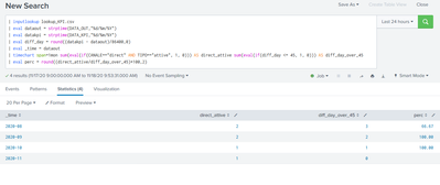

And the timechart one, just for good measure.
| timechart span=1mon sum(eval(if(CANALE=="direct" AND TIPO=="attive", 1, 0))) AS direct_attive sum(eval(if(diff_day <= 45, 1, 0))) AS diff_day_over_45

you don't know how grateful I am, not so much for the code,, which works great, but above all because you explained to me many things that were not clear to me.
Were you able to make me understand how to set up a search in splunk and understand how to use commands and functions together.
I answer your words, let's start with ... luckily I'm not color blind 🙂 so I understand all your steps well.
I have fixed some things in the code that I may not have explained well; the condition <= 45 must be applied only to those events that satisfy the first condition, i.e. I have to count:
1) how many are sum_for_direct_active (and here and OK)
2) of these sum_for_direct_active, how many are <= 45 ??
then your line:
| eval sum_for_diff_day_over_45 = if (diff_day <= 45, 1, 0)
I replaced it with:
| eval sum_for_diff_day_over_45 = if (CHANNEL == "direct" AND TYPE == "active" AND diff_day <= 45, 1, 0)
and I got the correct value.
Also I changed:
| eval perc = round ((direct_active / diff_day_over_45) * 100,2)
with
| eval perc = round ((diff_day_over_45 / direct_attive) * 100,2)
for which
| eval _time = dataout IS GREAT !! 😃
I took the stats instead of the timechart as a suggestion and also used
which seems to me a cleaner style instead of
| stats sum (eval (if (CHANNEL == "direct" AND TYPE == "active", 1, 0))) AS direct_attive sum (eval (if (diff_day <= 45, 1, 0))) AS diff_day_over_45 BY _time
I see it more complicated to read and understand.
YOUR SUGGESTION WAS GREAT !!😃
Thank you so much you made me understand a lot.😊

Ah, those sums.
I'm not quite sure if you then answered your own question?
In any case, leave off the `| stats ... ` and everything after it, and you'll see that the field 'sum_for_direct_attive` and that other field are both either 0 or 1 depending on the eval we did earlier.  Which that eval is really just a replacement for the previous examples inline evals in the stats command itself.
So, since we've created those fields before the stats command, we can just sum up the 1's and 0's of those events appropriately.
inline evals in stats can be great, but sometimes they just make the stats command really complex looking, so sometimes it's better to just split those out into their own little bits of logic so they're easier to understand and work on.
And in case you didn't figure it out, "-3mon@mon" would go back to August 1st.
You can mix and match those too.  "-90d" goes back 90 days from this time right now, but "-90d@d" goes back to the midnight that happened just before day 90 ago.
"-3mon@d" goes back three months, then backs up until midnight of that day to include the entire day from 3 months ago, instead of only the partial day.

Hi Rich,
now it's clear !!!
Eval generates a new field with the elements 0 and 1 depending on the true or false condition.
The SUM after, sums all the elements of the created field.
I had confused "sum" in the variable name,
The -3mon @ mon in my query took dates from 2020-08-18, for this I had to add:
| eval threemonthsago = strftime (relative_time (oldest, "@mon"), "% Y-% m-% d")
But now a strange thing happens to me (surely I'm wrong :))
if I put -9mon @ mon it takes into account the dates of February (ok, correct) but it goes until August and not until November as I expected.
IMPORTANT: at the top right I chose "latest 3 months.
If instead I write -3mon @ mon always with latest 3 months, it returns me from August to November
Why??
Does the latest 3 m3si have anything to do with it?
This behavior is not clear to me.
Anyway, I don't want to address all my doubts in this post, otherwise I will have to pay you for the lessons you are providing 🙂
I like to understand why things, but I certainly don't want to take advantage of your kindness and patience.
I still have to study a lot .......
You have already helped me a lot in understanding and making my query work.
I thank you for this
See you soon
Antonio
antonio147
Communicator
UPDATE:
I inserted these 2 lines at the top after the index:
| eval oldest = relative_time (now (), "-3mon")
| eval threemonthsago= strftime (relative_time (oldest, "@mon"), "% Y-% m-% d")
| where DATA_OUT> = threemonthsago
in this way I always take the previous 3 months starting from the first of each month.
If you want I can change the search to 4,5,6 .... months back by changing only the -3mon 🙂
very good solution !!!
Thanks to your suggestions

Hi Rich,
Thanks for the reply.
You're right, I asked the question but I didn't say what I expect.
I have already tried to use: | timechart count (DATA_OUT) BY Month but the result is always the same it calculates the count divided by month but only of the events returned at the end of the query.
Here are the data:
file _raw:
ID     LINK   CANALE TIPO              DATA_OUT                 DATA_KPI          ……………            1cond        2cond
 1       123     direct      attive         10/08/2020                 21/09/2020            ………….        (YES)        (YES)
 2      100      indirect  passive     15/08/2020                 24/08/2020           ……………      (NO)          (YES)
  3      213      direct     attive         11/08/2020                 11/09/2020            ………….         (YES)      (YES)
  4      333    compete natural      25/09/2020                 06/11/2020      ……………           (NO)        (NO)
  5      150      external  verify       01/10/2020                 24/10/2020         ……………         (NO)        (YES)
  6      223       direct    attive         07/09/2020                 09/10/2020            ………….          (YES)     (YES)
  7      224       direct    attive         13/10/2020                 30/11/2020            ………….           (YES)     (NO)
  8      122 indirect passive           15/08/2020                 24/10/2020           ……………       (NO)       (NO)
  9      216 direct attive                  01/09/2020                 18/11/2020            ………….         (YES)      (NO)
  10    217 direct attive                 01/11/2020                        null                        ………….          (YES)     (NO)
if the first condition is satisfied, total_count increase
if the first and second conditions are satisfied, count_event increment
RESULT 1cond: | where CANALE="DIRECT"  AND TIPO="ATTIVE"      total_count by month
Aug     2        (ID: 1,3)
Sep 2           (ID: 6,9)
Oct 1            (ID: 7   )
Nov 1           (ID: 10 )
Now I check how many of all these have a difference of 45 days between DATA_KPI and DATA_OUT:
I want the result to be:
RESULT    2cond: | where diff_day <= 45        count_event by month
Aug 2    (ID: 1,3)
Sep 1    (ID: 6)
Oct 0
Nov 0
Now the percentage for each of them (consider that the values are not that low)
My final table count by month:      perc=round((count_event/total_count)*100,2)
Mount         total_count        count_event        percent
Aug                  2                                     2                       100%
Sep                 2                                      1                        50%
Oct                 1                                       0                         0%
Nov                 1                                       0                         0%
so it sure is clearer 🙂
