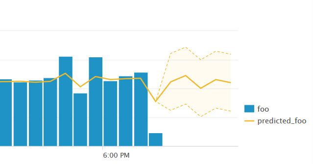

Richfez
Run anywhere:
| timechart count as foo
| predict foo AS predicted_foo
| eval upper95(predicted_foo)=if(_time<=now(), predicted_foo, 'upper95(predicted_foo)' )
| eval lower95(predicted_foo)=if(_time<=now(), predicted_foo, 'lower95(predicted_foo)' )
Of course change the time frame to something reasonable (last hour, last day, whatever). NOTE that the upper95(predicted_foo) in the eval has to be inside single quotes, otherwise it'll think it's a function or something, so be careful about that syntax.
That gives, on my data, something like
Predictions only
If you have any problems applying that to your own data, let us know because I'm sure we can help!
Happy Splunking!
