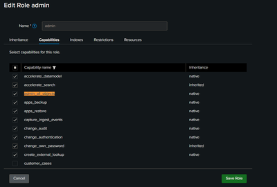

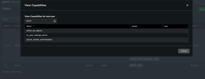

kiran_panchavat
@m_zandinia
To delete a report in Splunk, a user must have the delete capability assigned to their role. This capability allows users to delete knowledge objects such as saved reports, alerts, and dashboards that they own or have permission to manage.
Create and edit reports - Splunk Documentation
By default admin has the capability called "admin_all_objects", so he can delete the report.
admin:
Created test user called "test-user" and assigned user & power user role to that, and can see that admin_all_objects has not assigned.
Did this help? If yes, please consider giving kudos, marking it as the solution, or commenting for clarification — your feedback keeps the community going!

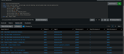

kiran_panchavat
@m_zandinia
Check this
| rest /services/saved/searches
| table title, eai:acl.owner, eai:acl.app, eai:acl.sharing, eai:acl.perms.read, eai:acl.perms.write
| rename title as "Report Name",
eai:acl.owner as "Owner",
eai:acl.app as "App",
eai:acl.sharing as "Sharing Level",
eai:acl.perms.read as "Read Permissions",
eai:acl.perms.write as "Write Permissions"
| sort App, "Report Name"
