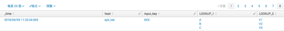

Hi,
When I lookup a csv file, and match multiple values, it will output as a multi-value fields .
Like that :

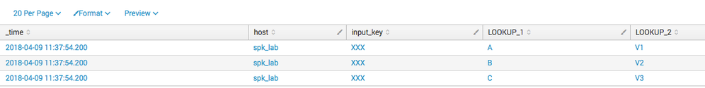

But, if that possible to expand the result as multiple records instead of multi-value record.
( like the result of "join" command does)
What I want will look like that :
I known there is a "mvexpand" command, but this command only accept only 1 fields to expand the record.
And because my lookup file is very large and it is the time-based lookup, so it is difficult to change the "join" command instead the "lookup".
Any idea?
