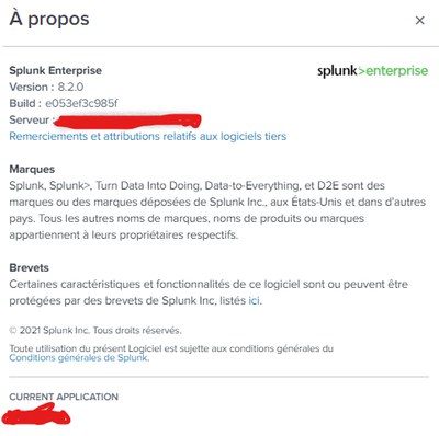

mclane41
I work with the version Enterprise 8.2.0

richgalloway
Which version of Splunk are you using?  The first query works for me in 9.0.0.1.
