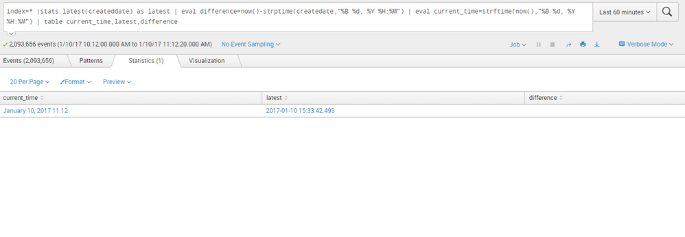

vrmandadi
Builder
Hello Somesh,I have attached an image which shows the results
DalJeanis
Legend
typo problem, missing d in the second createddate -
index=abc |stats latest(createddate) as latest | eval difference=now()-strptime(createddate,"%B %d, %Y %H:%M") | eval current_time=strftime(now(),"%B %d, %Y %H:%M") | table current_time,latest,difference
somesoni2
Revered Legend
The name of the field createddate was changed to latest after the stats. Try the updated search.
vrmandadi
Builder
Well I tried the updated one but it is still the same the difference field is blank and none of fields are converted
somesoni2
Revered Legend
My bad, I followed the wrong field for timestamp format. Please try the updated answer now.
