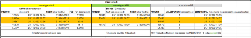

I want to join 3 sources from the same inidex. The Problem is, that with join i lose Date because im over 50.000 results in the subsearch. So i try to get my table over the "normal" search.
Logic is like the picture: The source "NAS" is a reported fault on a specific Production-number (PRODNR). it includes the Productionnumber, the timestamp of the detection and a clear ID (SNSM - for every fault) with the Partcode of the fault part.
The "NAU" is the data of the processed/closed defect. Problem here is as you can see that the columns in the sources have the same names.
The MP is the number of the process Step.
so every source contains the PRODNR.  The NAS and NAU contain the SNSM IDs.
So i want to join the NAU ans NAS by the "SNSM" IDs and see if they alsready passed the Progress step 6 and if a fault was proccessed before the step 6 or if it was open the time the Production Number passed the Step 6.
my search that works is as shown. But its limited to the 50.000 results.
i try to to make it with index=pfps-k sourcetype=NAS OR sourcetype=NAU OR sourcetype=MP.
I get all the data but i cant do the same like the join so compare the SNSM IDs and then the Productionstep

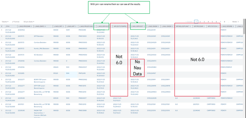

index=pfps-k sourcetype=NAS ( PRODNR="1*" OR PRODNR="2*" ) |where 'SPERRE' like ("PZM51%")
|dedup PRODNR,PRUEFUNG
|join type=left max=0 left=NAS right=NAU where NAS.SNSM=NAU.SNSM [search index=pfps-k sourcetype=NAU ( PRODNR="1*" OR PRODNR="2*" ) |dedup SNSM]
|join type=left max=0 left=L right=MP where L.NAS.PRODNR=MP.PRODNR [search index=pfps-k sourcetype="MP" earliest=@d+6h |where MELDEPUNKT=6.0 |where like(PRODNR,"1%") OR like(PRODNR,"2%")]

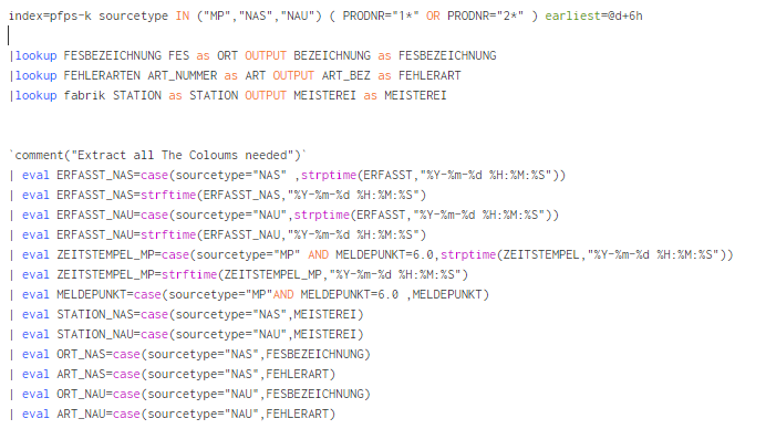

Hey thank you! Yes i know this post. I try it like for a week. I searched every Topic here. MY Problem is that i need the coloumn SNSM to be shorn in my results for the source=NAS and for the source=NAU. like rename them to SNSM_NAS ans SNSM_NAU... so i can compare if they are the same or if the SNSM_NAU is missing. Nothing worked for me till now. I need a easy join left for all thre sources and compare the SNSM numbers. Without the issue of missing Data

index=whatever sourcetype IN ("MP","NAS","NAU")
| eval step6_time = case(sourcetype="MP" AND meldepunkt="6",strptime(zeitstempeli,"%d.%m.%Y %H:%M"))
| eval detection_time = case(sourcetype="NAS",strptime(errfaast,"%d.%m.%Y %H:%M"))
| eval process_time = case(sourcetype="NAU",strptime(errfaast,"%d.%m.%Y %H:%M"))
| eventstats values(detection_time) as detection_time, values(process_time) as process_time by snsm
| eventstats values(step6_time) as step6_time by prodnr
| where sourcetype="NAS"
| eval result = case(isnotnull(process_time) AND process_time < step6_time,"fault processed before",isnotnull(process_time),"fault processed after step 6",isnull(process_time),"fault not processed")

hey thank you! yes here they are. It has to look like this. I Need all Source datas one next to the other and liks the NAU and NAS data by the SNSM as you see. at the end i want to show the 6.0 for every PRODNR in the data. and i need the empty fields, so i know if the issue is closed and if it is before or after the 6.0 point
