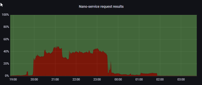

Hi,
Am quite new to splunk so lease bear with me if I ask obvious questions. However things that were relatively simple in grafana (which we are coming from) seem uge tasks here in splunk. So I do hope someone can help me with the following ...
I have this index,  in whch a field, ms_result is extracted.   This field can have numerous resultcodes. Only 2 of them are good ("OK" and "200-10000"). All other codes are errorcodes.
Now I would like the total of the events with an errorcode to appear as a percentage of the overal total of events withing this search (per minute). So let's say, we have 1000 events, and 100 of them have an errorcode, then 10% should ben shown on the (area) graph.
Below the picture I would like to recreate. Is this by any means possible?
Thnx

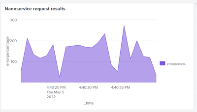

ITWhisperer
What was the search that produced that chart?
ericvdhout
index="aiam_apigw_app_idx" event_type="APIEND" |  bin starttime as _time span=1m
| stats count as total count(eval(ms_result=="OK" OR ms_result=="200-10000")) as OK by _time
| eval errorpercentage=round(100*(total-OK)/total,2)
| fields - OK total
ITWhisperer
| fields - OK total
