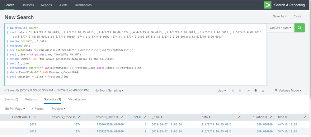

screenshot below:
hope it helps

screenshot below:
hope it helps
