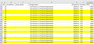

Rithekakan
Hi gcusello,
I have this report, and I want to filter out Plugin Name = TLS Version 1.1 Protocol Deprecated with Port = 8443 and 8444.
Thanks for your help,
Rithekakan

Rithekakan
Hi @gcusello
yes
  • Port=8443 OR port 8444
Yes I 've been using your search, but I don't know why it also filter out other value of the Filed " Plugin Name"
I am still get stuck and keep modifying the conditions.
Thanks for your help @gcusello
Regards,

Rithekakan
@gcusello
Yes exactly, I use it.
This is my full search..
host="SPL-SH-DC" sourcetype="ABCSW"
NOT Severity IN (Info,Low)
NOT Port IN (6502,8089,8001)
NOT "Plugin Name" IN ("SSL Certificate with Wrong Hostname","SSL Self-Signed Certificate","SSL Certificate Cannot Be Trusted")
| lookup ABCDEFGServerInventory.csv IP_Address as "IP Address" output Host_Name, System_Type
| eval days_since = floor((now() - _time) / 86400)
| eval Pending_since = case(days_since == 0, "Today", days_since < 30, "Pending (< 30 days)", days_since > 45, "Pending ( > 45 days)", days_since > 30, "Pending ( 30>Days<45 )", days_since < 45, "Pending ( 30>Days<45 )", days_since > 1, days_since . " Days")
| stats values(*) as * by "IP Address",Plugin,"Plugin Name",Severity,Protocol,Port,Exploit
| eval status = case(mvcount(source)>1,"Pending", source=="ABCDEFGSW26062022.csv","Fixed", true(), "New Vulnerable")
| search "IP Address" IN ("1........,...................................")
"Plugin Name" != "OpenSSH S/KEY Authentication Account Enumeration"
"Plugin Name" != "OPIE w/ OpenSSH Account Enumeration"
"Plugin Name" != "OpenSSH >= 2.3.0 AllowTcpForwarding Port Bouncing"
"Plugin Name" != "OpenSSH PCI Disputed Vulnerabilities."
"Plugin Name" != "TLS Version 1.1 Protocol Deprecated" (Port ="8443" OR Port="8444")
| table "IP Address",Host_Name,"Plugin Name",Severity,Protocol,Port,Exploit,System_Type,Synopsis,Description,Solution,"See Also","CVSS V2 Base Score",CVE,Plugin,status,Pending_since,source
Rithekakan
@gcusello
sorry,
  • Port=8443 OR port 8444 is correct.
Rithekakan
Hi @gcusello
yes
  • Port=8443 AND port 8444
Regards,
