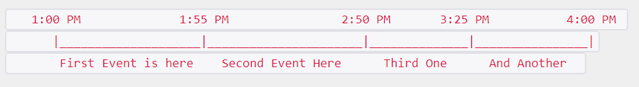

I want my timechart to display other data on the x-axis aside from the time itself.
To be more precise, I would like the chart to represent data like this:
This is probably impossible to achieve without adding a custom CSS file, but maybe I can make some transformation in my search so I can read "Third One" when I hover over the 3:14 PM mark, or "Second Event Here" when I hover on the 1:59 PM mark.
Any ideas about how achievable this is?
Thank you for your time!

kkos94
That does indeed look like what I'm thinking of doing.
Thank you!
Is there a way to display these annotations under the x-axis? Kind of like a second axis overlapping the time axis?
Not sure if the way I worded it makes sense.
chrisyounger
No I just the flags that overlay as per those screenshots.
If you really need annotations under the x-axis you would need to create a custom visualisation that can render like that.
kkos94
Thought so. Thanks for pointing me in the right direction!
